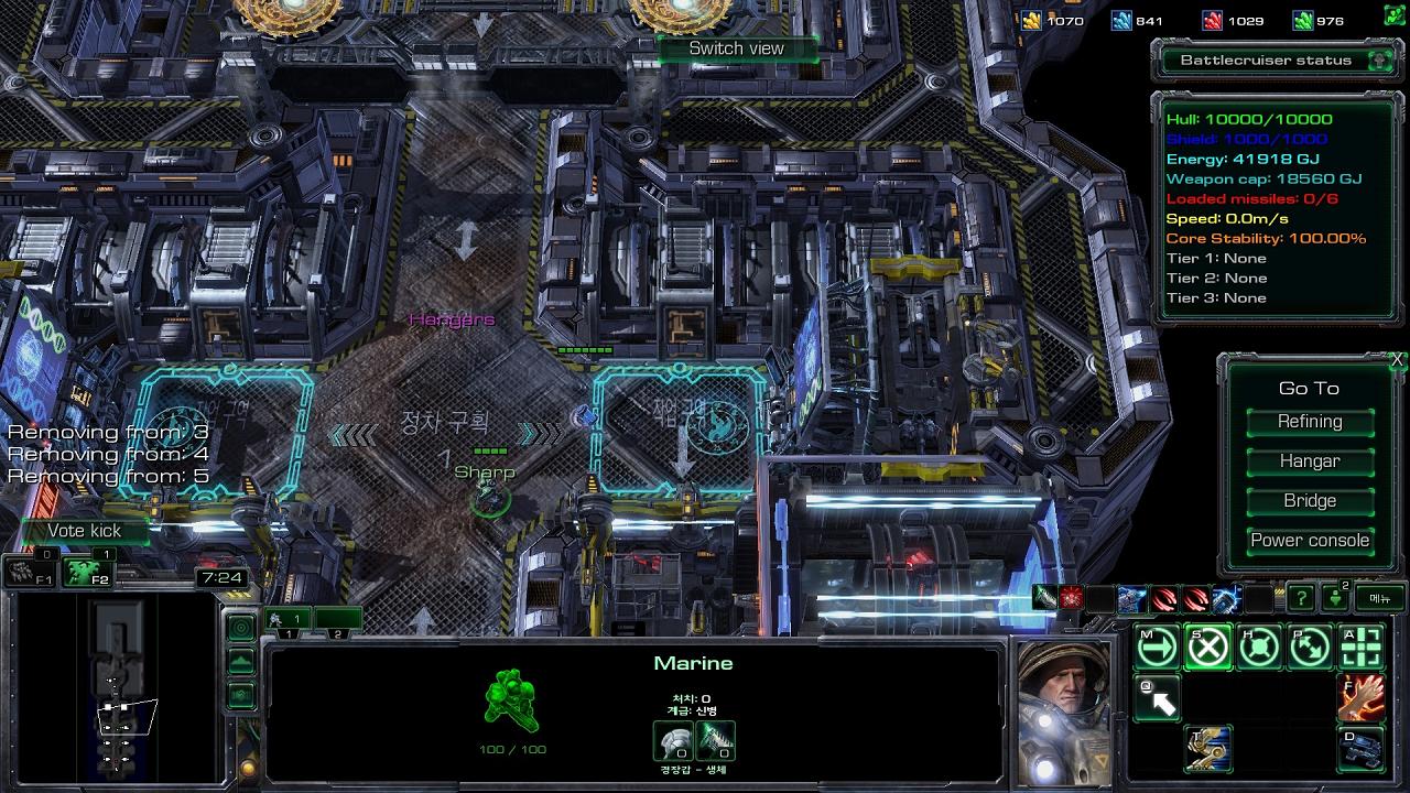

OK, there are some bugs on the beta.
- The messages 'Removing from : (number)' will be displayed for some reason. At least I think that it appears when you handle items.
- Your marine can wear C4, missiles, etc by moving them to armor slot like screenshot. This bug occurs on hangar console or when you pick up items. So you can infiltrate with 7 C4.
- When your marine's inventory is full, and if you click the items of ship inventory, it will just disappear unlike when you click the withdraw button.

The message is just a debug message. Sometimes I forget to remove them.
I haven't been able to reproduce your second bug. When I try to move an item into the armor slot, it says "Can't move item"
The third bug with the disappearing items is confirmed. I'll fix it asap.

Umm, that bug doesn't appear when you move items directly. I'll give you more detail.Siretu wrote:I haven't been able to reproduce your second bug. When I try to move an item into the armor slot, it says "Can't move item"
Sequence
1. Purchase some items and pick them up.
2. Move your marine to hangar console. Then window about small ships will be displayed.
3. Select any small ship, and deposit items by clicking each item in your unit inventory.(not deposit button, just click the item directly)
4. So your small ship have some items now.
5. Click the items in your ship inventory so that you can move them from ship inventory to unit inventory.
6. repeat 3 ~ 5 process until you can see the bug.
7. Soon or late, one of the items will disappear from your ship and unit inventory.
8. Leave the console and check your marine's armor slot.
It would be help if you watch 'Cruiser Command Beta.SC2Replay'. You can see the sequence from 5:20 to 5:40
I apologize if my explanation has been short.
Re: New Hangar changes on beta
I tried your explanation but I didn't manage to replicate it, so I looked at your replay and everything became clear.
It turns out what you found wasn't really related to the hangar inventory at all. You just found an old bug related to the frequency nullifier that hasn't been noticeable until these new hangar changes.
Basically, I added some code to make it so you don't auto-equip frequency nullifier (since it drains health when you pick it up). The way I did this is just by detecting when you pick it up and move it to a different slot. However, due to some ambiguity in Blizzard's documentation and stupid naming, there was a bug in how it calculated the next empty slot. Due to this, when you moved the frequency nullifier to your inventory, it calculated the wrong slot to put it in and put it on the shield, thus swapping the shield to the armor slot.
Fortunately, it was a pretty easy fix and it should be solved now. I'll publish a new version with all the bugs you mentioned solved.
