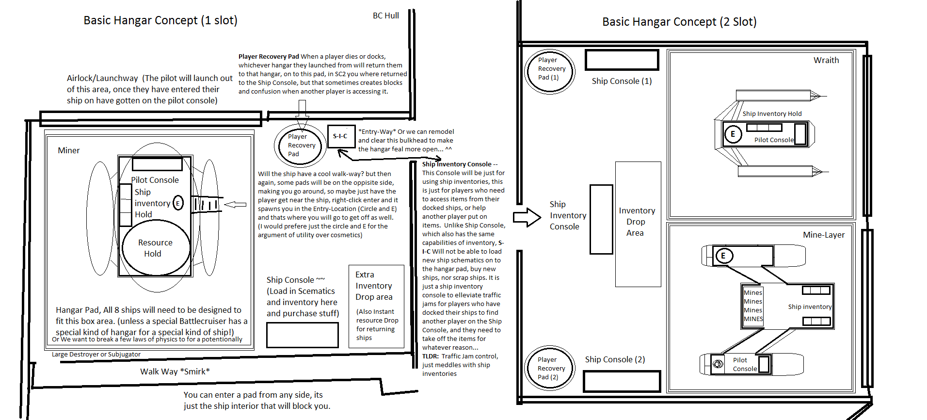

Posts: 263
Re: Docking, Hangar and Small ship interiors. Oh my
We might have a problem with small ships being able to physically be in the hangar, if you want to try to fit 10 destroyers in the hangar, the hangar will have to be half the battle-cruiser and the BC will have to SCALE to huge proportions to be able fit with scale.
Also, some battlecruiser designs might have several hangars to fit with their design ideas and benifits/drawbacks
And, what about docking, where will the ship go? are you going to just FLY THE THING into the porthole of the hangar...especially if the battlecruiser is on the move....in combat? while launching ships is totally doable and cool, docking them will be a pain.
Herez mah solution ~
Youl have hangar slots like before, but the difference is that you will directly load the ship you want on to a pad, or if a ship is already loaded on to there, you can just select another ship and the game will load another one on (want to have a cool animation like in warcraft 3? or just insta cycle through the ships O.o)
Once ready, you can fly it out all cool like ^^
Heres my pretty paint picture to illustrate some points, and introduce some other ideas as well.
Hangar Design Ideas.png (102.45 KiB) Viewed 610 times
