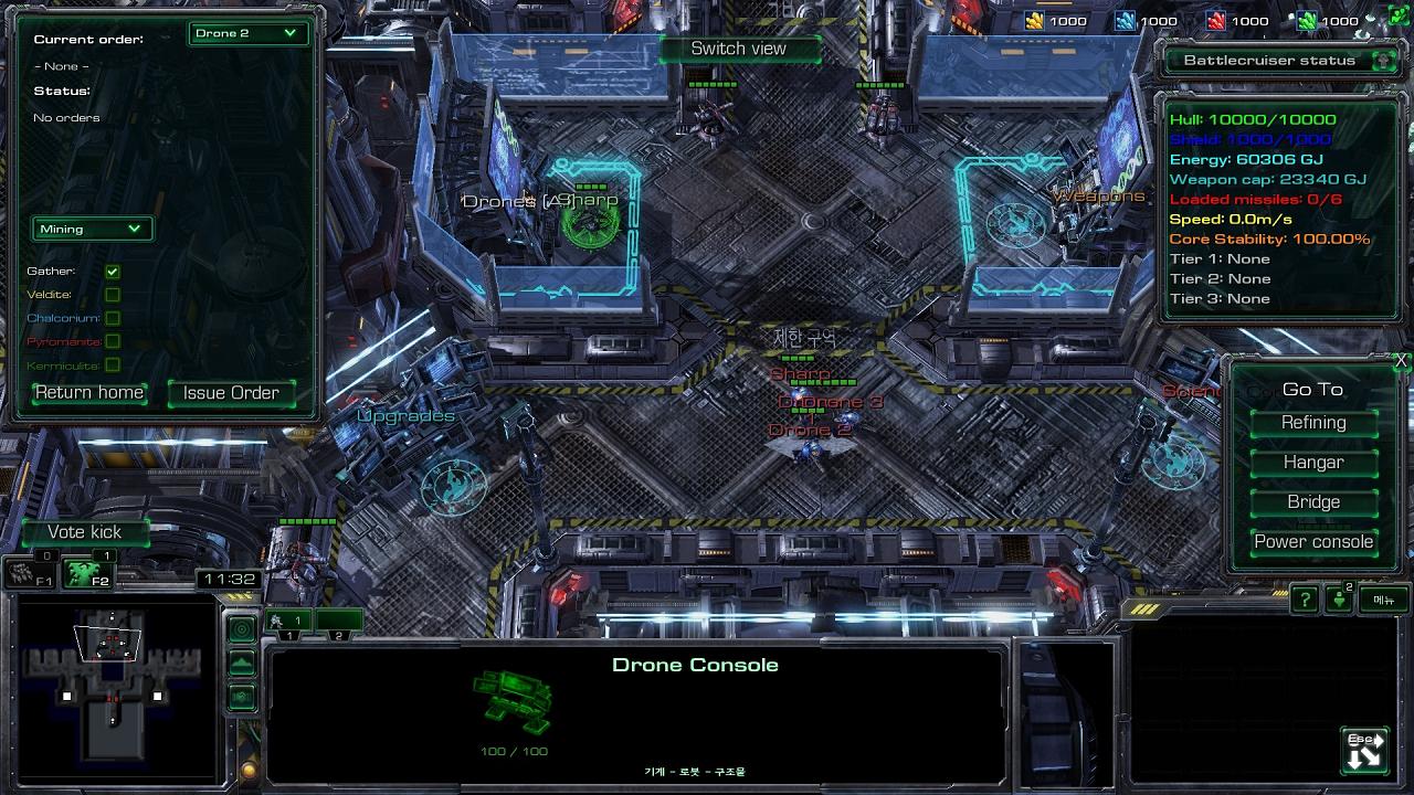

2. If you deposit repair stations into a small ship, you can use them although you are on the small ship. But the repair station dosen't appear nearby you. Attached screenshot will show you where the repair station is.
3. This glitch is about drone console. If you check 'Gather' box and other boxes will be checked automatically. It's fine up to this point. But if you choose the next drone, then you will see that only 'Gather' box is checked. Therefore you need to check other boxes or click twice 'Gather' box.

2. Yep. I added a validator to make sure you can only repair inside the BC.
3. Yes, you're right. I'm not sure what the best behavior for this is. Saving the state of the check-all button for all drones would be a bit silly so for now I just uncheck it every time you change drones.
